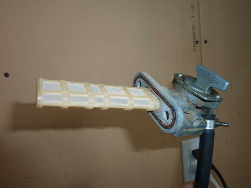

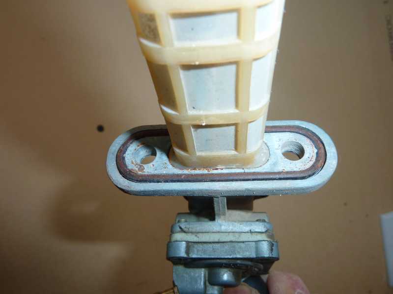

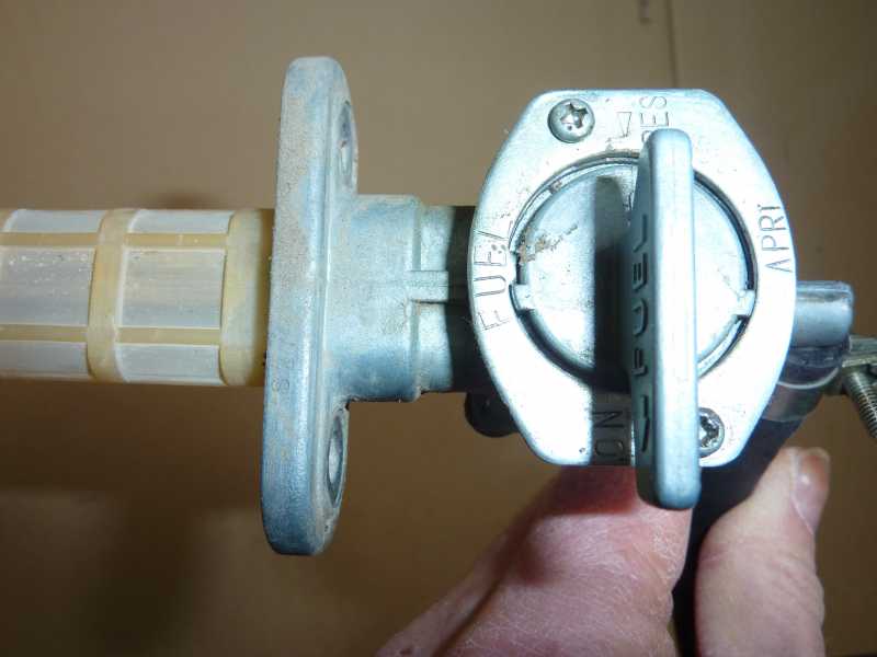

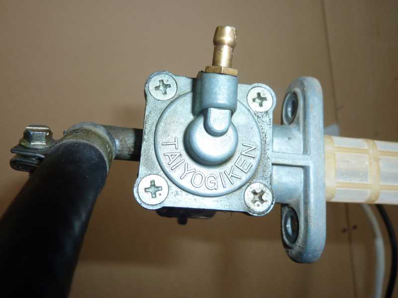

Can't find a part # on the fuel tap so hope the photo's help. The hole position on the tap was not exactly correct for the bottom of the tank, but only a minor mod required.
The vacuum to open the diaphram is from any one of the threaded screws on the intake manifold.
Just one point about the filter being on the inside of the tank- if the tank is in good shape with no rust or other grud that could bloke the filter, then the inside filter is a good idea. If the inside of the tank is somewhat suspect, then an exterior filter that can be seen and cleaned when necessary is probably a better idea. In other words, if the interior filter plugs on a ride somewhere , it will be quite difficult to clean it on the side of the road
Last edit: 12 years 9 months ago by tackelhappy. Reason: correction
