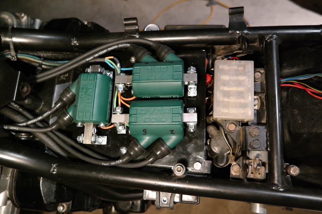

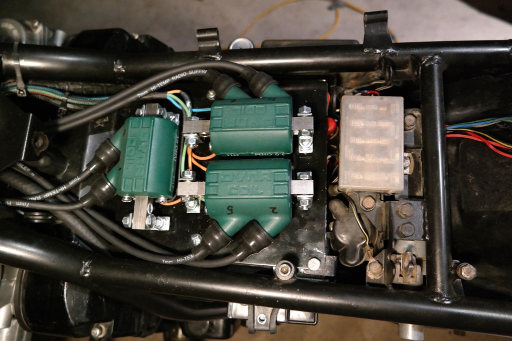

Try closing your plug gaps a little which can help starting (hotter spark).
Alternatively do the AW82 coil mod if not already.

The ignition has been properly sorted on this one...

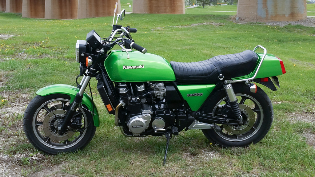

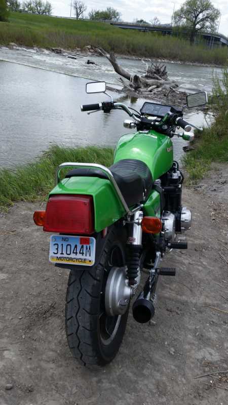

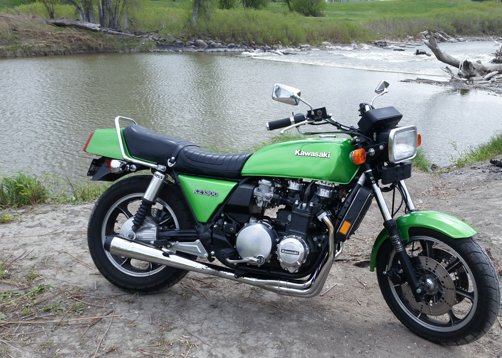

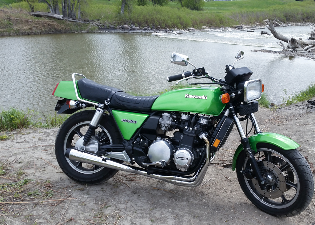

Here a few pics of the bike I took today. All done.
