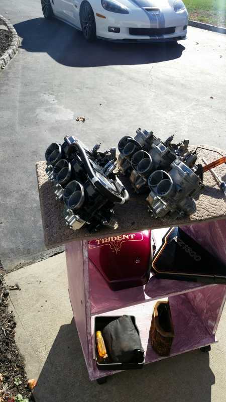

Got the old carbs off and prepping to install new ones after tank sealer has set. I have a question about the gizmo that is between the fuel tank and the carbs, located under the airbox. What is it and what does it do?

out with the old and in with the new. well, new to me...

If I am right this is the magnetic fuel valve. Once you turn the ignition to on it will release the flow of fuel to the carbs. A lot of people took it out, I have (had) it connected to one of the switched I did not need, so I can cut the close to hoem in order to empty the carbs a bit.

2shortofasixpak wrote: Got the old carbs off and prepping to install new ones after tank sealer has set. I have a question about the gizmo that is between the fuel tank and the carbs, located under the airbox. What is it and what does it do?
Looks a bit like the fuel solenoid but it's hanging a bit lower than what I'm used to. Having said that, mine being a sidecar, what I am used to may be a lot different than anyone else - I have a secondary fuel tank that also has a fuel hose going to the solenoid.
