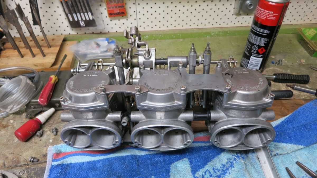

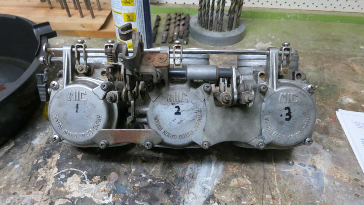

Carbies before clean
Carbies after clean
New carbie Kits were installed on all three with viton o-rings
3 New ignition coils

The carbies are back on the bike although I still have some sorting out to do as she is kicking over but won't start. The problem with the starter solenoid getting hot is not an issue now and the motor turns easily.

Update
I have removed the carbies from bike and stripped them down twice since my last post and I'm aware there are a few other members who have had the same fun and experience. Most would know from my other posts that I have had problems getting the bike to start, then idle. The problem turned out to be the novice mechanic who connected the wires onto the ignition coils primary connection incorrectly, so the firing order was all out. To my credit I did manage to get one right :whistle: (ignition coil connection)so when the bike started it was always only firing on 1 and 6 cylinders. Amazingly it sounded ok even with just the 2 cylinders firing. That being said, it has been a long time since I heard the bike firing at all. I swapped the HT leads around for a quick test and 'voila' all cylinders seemed to be up and running. Tomorrow I will change the primary winding connections and do a full test with the 'Colortune' and make absolutely sure. If all works out then I will be able to synchronize the carbies which will be another first for me.
