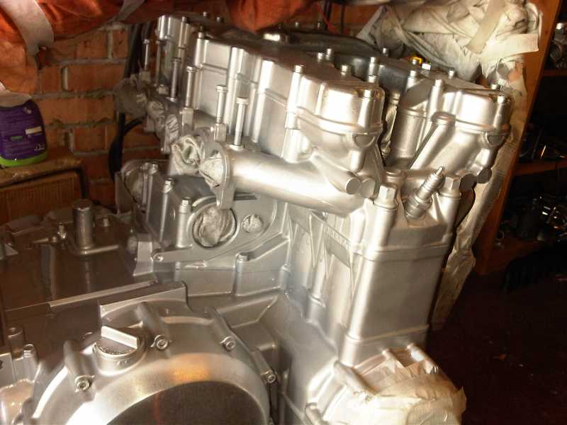

Re: (K)Z1300 riddle
12 years 10 months ago
The REAL UK spec bike had no reed valves at all.
See my current engine below.........no reed valves.
