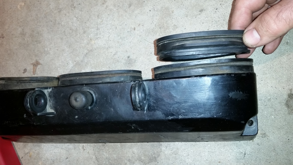

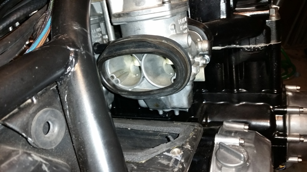

The air box boots that were on this bike are incorrect, I'm not sure but I think the previous owner has used ones from a voyager. They fit when stretched over the carb but they may be causing some leaks, and it's possible they are messing with the air flow to ports on the side of venturi. I crawled up into the attic and pulled down some spare air box parts and now I'm sure they are wrong.
I installed the old ones but they are in tough shape, thet will work well enough for me to test my theory. Then I will have to get some replacements.

One thing you might need to check not sure if it's just the pic but it looks like you have the slides stuck open a bit in the carb.

Yes, its certainly possible that ill fitting boots will cause your grief.
